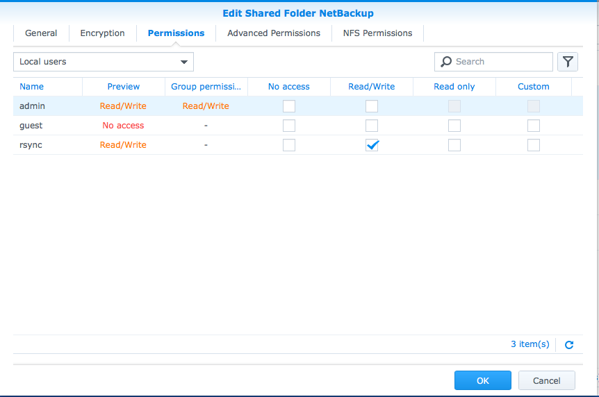

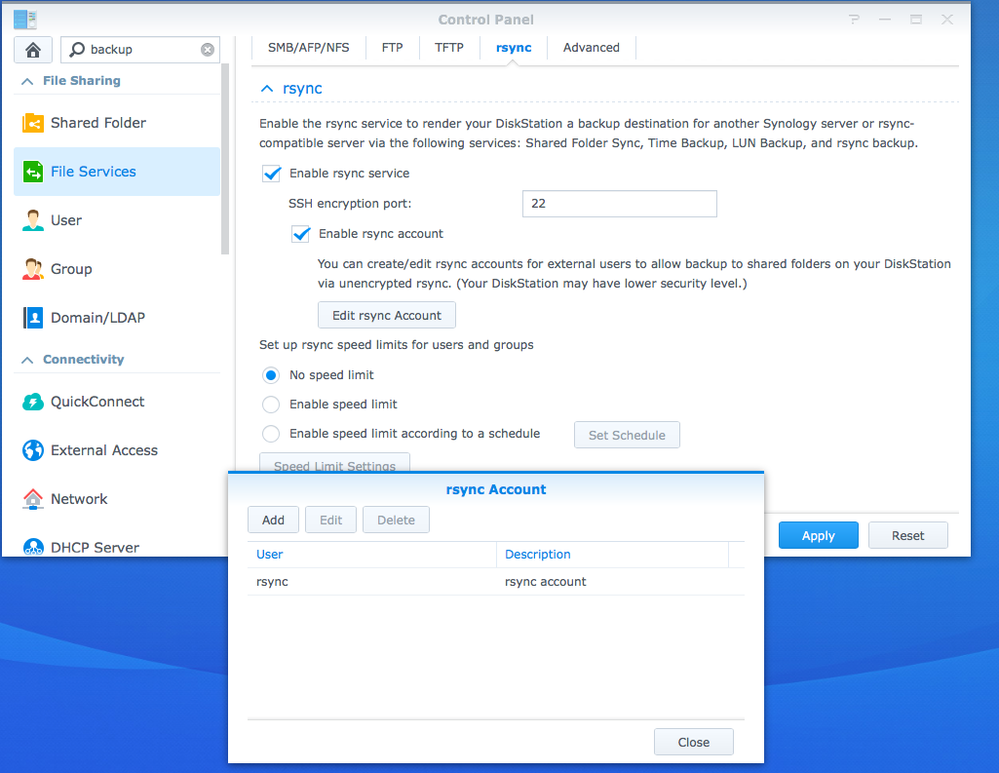

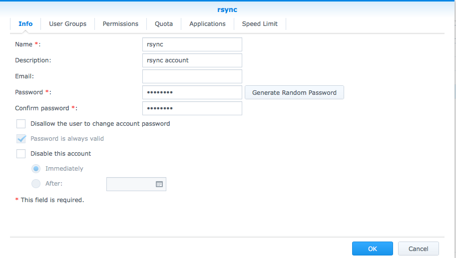

When if saved this backup configuration, and ran it, I received an error message telling me that the account was disabled. I could not figure out why this message was shown as I had setup everything by default on the Synology. I did notice that one setting I had not enabled as it was descibed in my humble opinion to be not needed. This was the "Enable rsync account". I though it would be worth the try to enable it and click on the "Edit rsync Account" button. This opened up a window with rsync accounts which showed to be empty. I clicked on the "Add" button and selected the rsync account which I had already created for the Rsync service and entered its password again. After saving it, suddenly the Readynas Backup worked after running ir from the Readynas Backup page.
Making it complete; I have also screenshots available of the Synology Rsync service configuration that worked for me however, I can only upload one attachement but no zip. any ideas how to add the couple of screenshots I have?
Keep in mind, I created a dedicated user called "rsync" which would only be allowed access to the Rsync NetBackup share location with Read/Write.

xbmcgotham
Oct 08, 2019Tutor
So found the solution. Dont ask me how or why, but it works now suddenly.
After many tries, this is what I found to be the correct format of entering the backup destination info when connecting to Synology Rsync service from a Readynas NV+ v2 running Radiator 5.
BACKUP DESTINATION
Type: remote
Name: remote: Rsync Server
Host: xxx.xxx.xxx.xxx
Path: NetBackup
Login: (username of the account you created on the Synology for the rsync service)
Password: (password of the account you created on the Synology for the rsync service)
After clicking "Test Connection" this should give a Successful message.

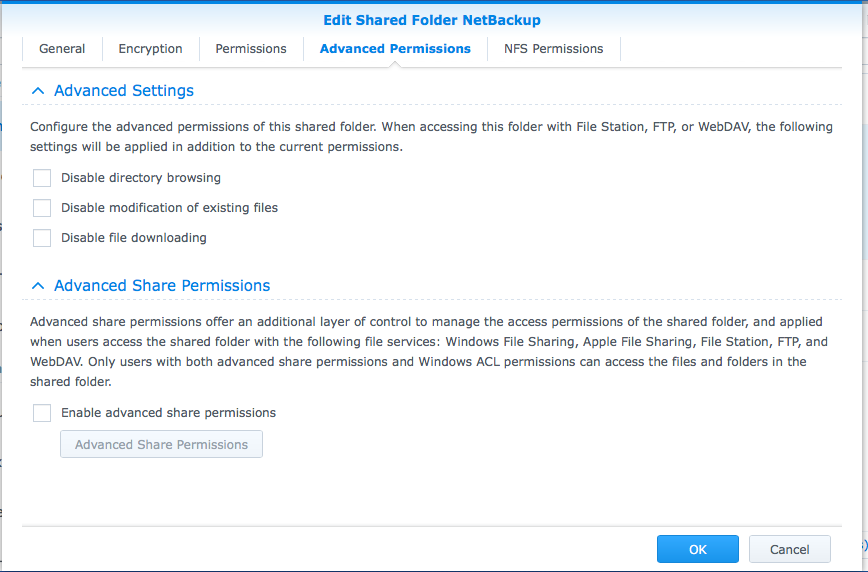

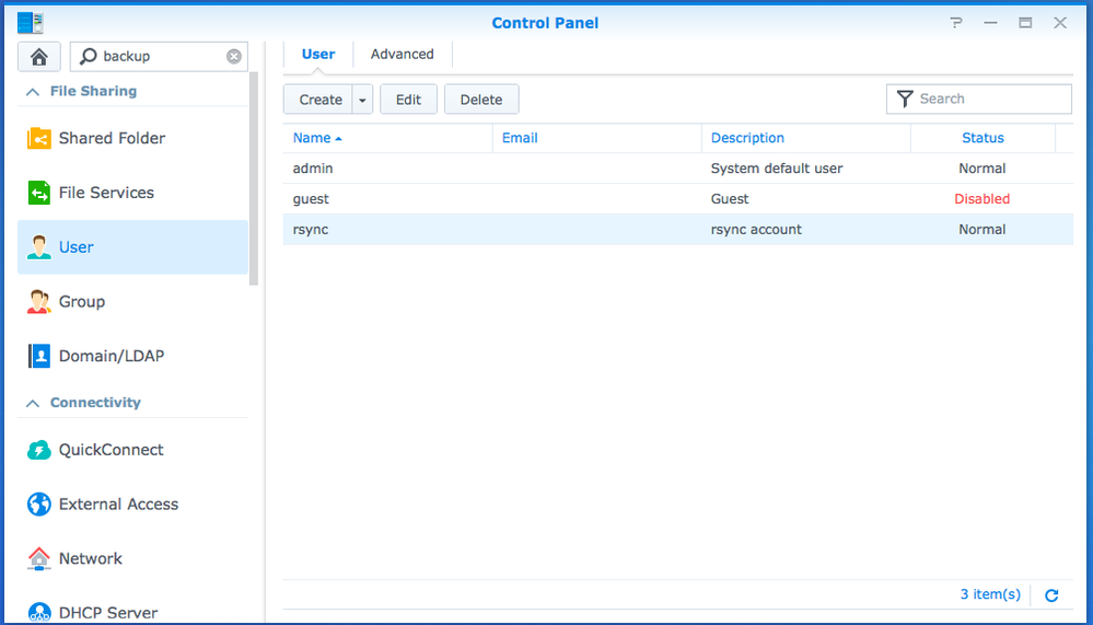

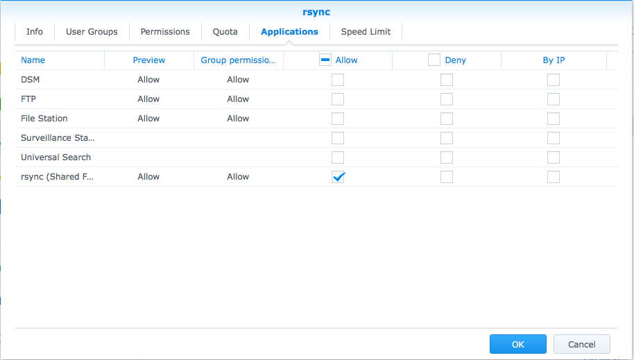

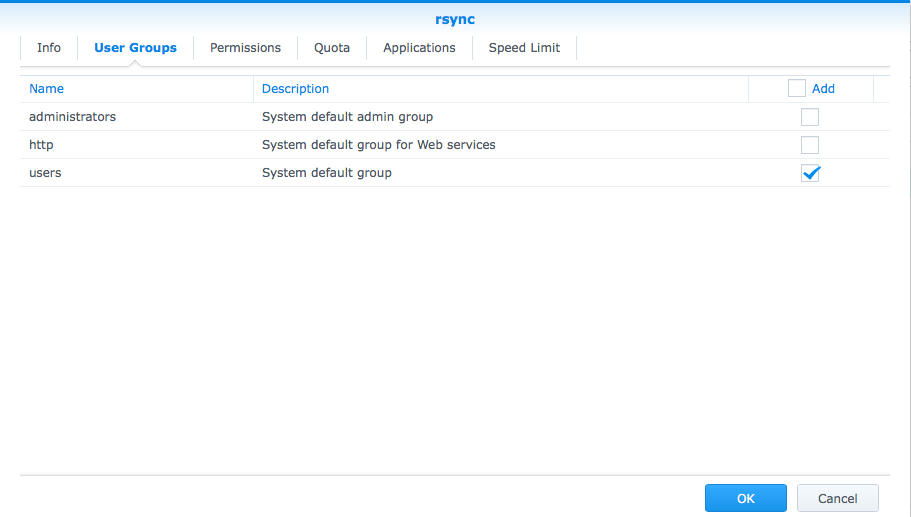

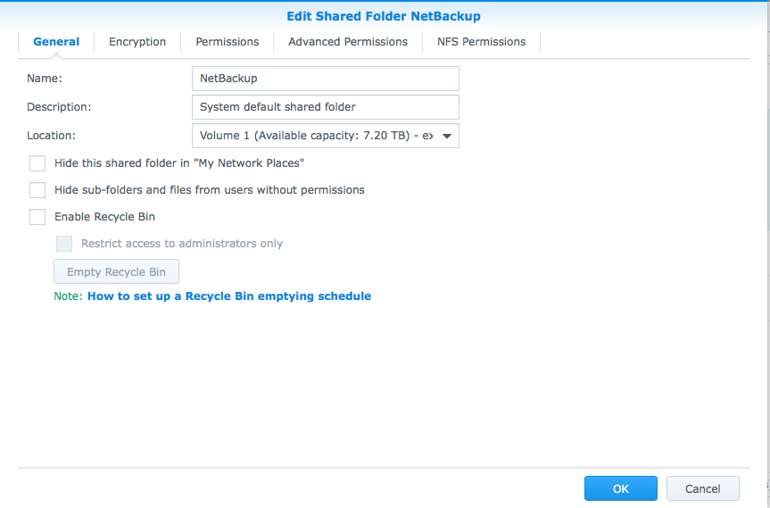

Hope this helps others.
- StephenBOct 08, 2019Guru - Experienced User
I see "Photos" icon in the toolbar that I use to post screenshots. There can be more than one in a post.
If you don't see that, maybe post a downloadable link to the zip. Then I can reply with the screenshots, so they will be persistant.

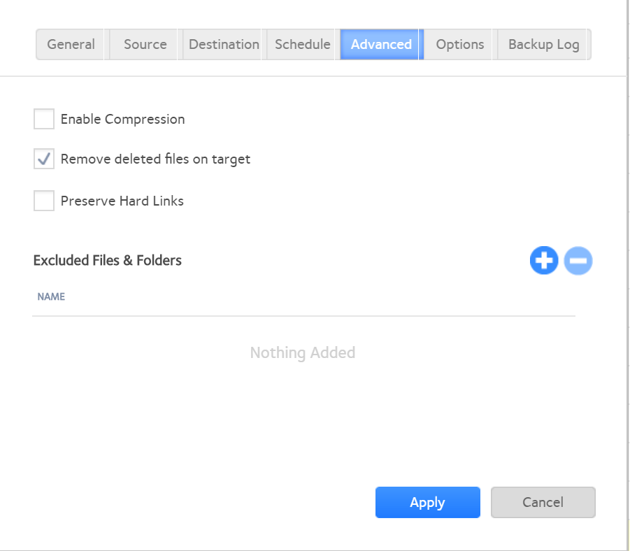

I also think that OS5 doesn't have this option to delete files on destination, its not in the option list, see screenshot attached. No worries as this probably means that it will make a proper mirror anyway.
You might not have the option - there is an old post here saying it wasn't in 5.3.5, but nothing more recent. I believe that if you don't have it, the Synology will include files that aren't on the NAS. You can test this by creating a test file, waiting for it to be backed up, then delete it on the NAS (and see if the deletion propagates when the backup runs again).
If you don't have it, then you could look into the synology backup tools - which should be similar to the ReadyNAS. They might have this option, and they might also have the scheduling options you are looking for.
FWIW, Your screen shot is similar to the one on OS-4 and OS-6. The option I am referring to is on an "advanced" tab just for rsync in both of those. In OS-6, it looks like this:
The wording in OS 4 is confusing - "remove deleted files on source" if I remember it correctly. But it does the same thing.
I do think its not in my version as everything is similar but "advanced" tab is not present. I did notice it being present on my other Readynas Duo.
