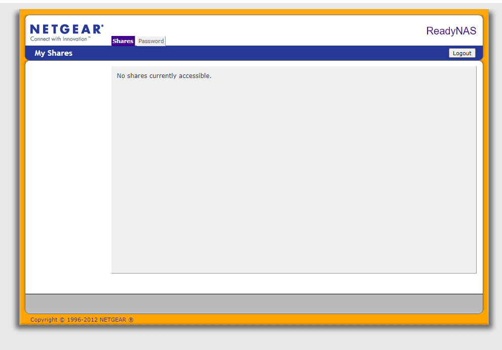

Yes I enabled SMB 1.0/CIFS client - I am using Win10. It is recent behavior yes, although I was getting the invalid SSL protocol error I could usually ignore the warning and continue. I can access the drive via the IP in my browser but I only have two options: shares or password. As mentioned if I go to shares: "No shares currently accessible."
No idea where the rest of the admin menu options have disappeared to!
I'll maybe try Samba from my Ubuntu box tomorrow, I'm just thankful that I managed to get my content from my drive. If anyone else is strugllnig to mount their drive in Ubuntu these instructions may come in handy:https://technostuff.blogspot.com/2012/06/how-to-mount-disk-used-by-readynas.html
Here is what I see currently when using a browser.

This what you get if you browse to http://nas-ip-address. This is NOT the admin UI. You were redirected to https://nas-ip-address/shares. You see No shares are available because you did not enable http/https for any of them.
Getting to the admin UI (frontview) requires you to browse to https://nas-ip-address/admin.
If you do that with Chrome, FireFox, Safari, or Edge with default settings, then you will get an SSL Version or Cipher Mismatch error in the browser. You will find that you cannot click through this error. It is because the NAS web server doesn't support TLS 1.2, and browsers began requiring that about a year ago.
Options for working around this are here:
But to get temporary access, you can use Edge in IE mode or FireFox. In the case of Firefox, you need to set security.tls.version.min to 1 (browse to about:config and search for the setting).
