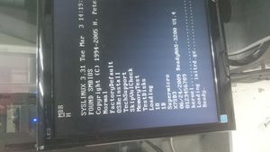

Boot stuck at ready

Have you tried USB Boot Recovery?
- bongolanMay 30, 2017Aspirant
tried it, but it showed the same display.
steps done,
poweroff
Insert USB drive
press reset
turn on
keep reset pressed for 15 seconds
Is there a wrong step?
Should the usb boot recovery be showed on m display?
- mdgm-ntgrMay 30, 2017NETGEAR Employee Retired
I think it's the backup button you need to press though the 3200 doesn't have a backup button. You might need to hook up a VGA keyboard enter the BIOS and get it to do the next boot off a connected USB device.
I think the syslinux version for USB Boot Recovery may be newer than the one on the internal flash which could be how you can tell if it's booting properly off the external USB.
