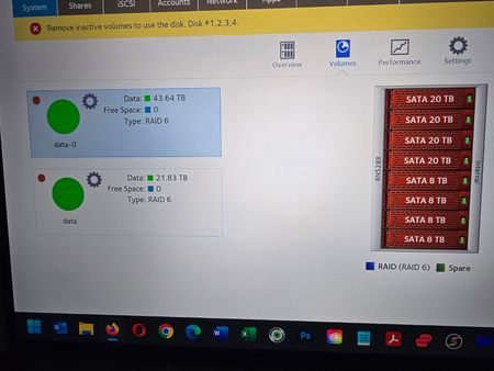

Broke my Readynas 528X
Nov 26, 2024 12:06:53 PM System: ReadyNASOS background service started. Nov 26, 2024 11:45:23 AM System: The system is shutting down. Nov 26, 2024 10:55:27 AM System: ReadyNASOS background servi...

Can you let us know what you were doing?
Do you have a full log zip file?
- sluggo5505Feb 03, 2025Aspirant
Sorry it took so long to get back to you.
Don't remember what caused the failure and I do have a log zip file. How do I get it to you?- StephenBFeb 03, 2025Guru - Experienced User
Don't remember what caused the failure and I do have a log zip file. How do I get it to you?You can put it into cloud storage, and send me a Private Message (PM) with a download link. Make sure the permissions are set so anyone with the link can download. Send the PM using the envelope icon in the upper right of the forum page.
