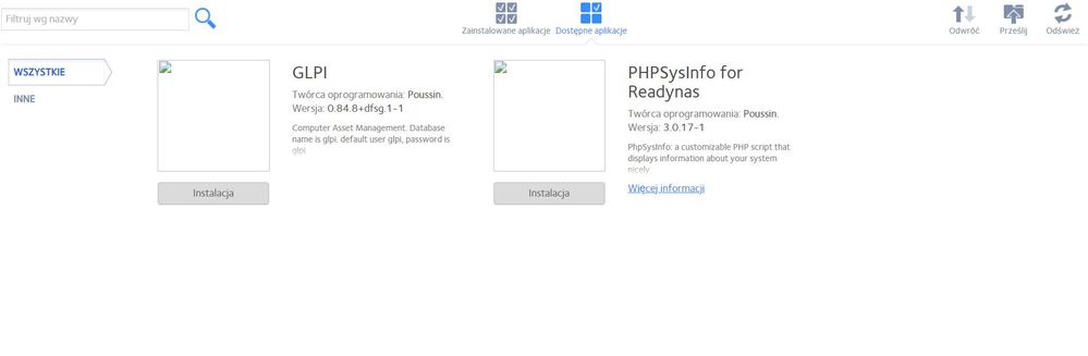

The fist issue was, that on my applications page there is quite nothing to show:

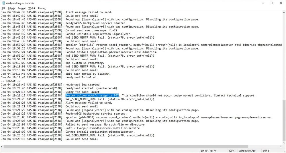

I've downloaded logs and I've found in readynas.log a very suprised information:

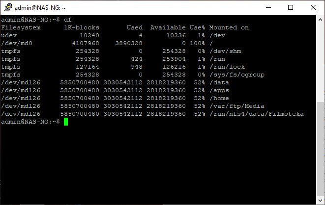

After that I've logged to readyNAD by ssh and when I've entered a df command result is as below:
As I understand, the issue is because there is no availiable space on /dev/md0/
The question is: how can I make more avaliable space on that volume? Will it fix issues with application installation? As it is written in in readynas.log - this is not a normal situation and I would like to have my ReadyNAS working still fine.

I think the problem is with the loganalyzer app - which (if I recall correctly) is using space on the OS partition.
If you don't have a backup of your files, I would definitely take care of that first. A full OS partition can damage the NAS configuration files - though paid support can fix that, it'd be better to avoid the cost.
Then try uninstalling loganalyzer. There might be some more cleanup needed after that.
