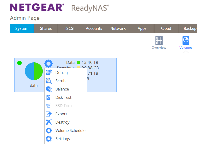

      Also not sure how to "Balance from volume"
        Navigate to the volume page, and click on the volume settings wheel.  There is an option to run a balance from there. If you've never run one, then it can take quite a while to complete it.
