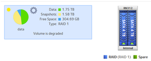

Failed Drive Replaced, Recync Complete, But Volume Is Still Degraded
My RN312 has been working fine for many years. Just recently, one of the 4TB WD Black drives indicated a failure. I removed the failed drive and replaced it with a newer 4TB WD Black drive with the...

FYI -- I had no problems formatting the drive on a computer. The second 4TB drive (also removed from the RN516 when upgraded) was blanked, formatted, and added to the array, but it resulted in the exact same result -- the resync completed and the drive was marked ONLINE, but the volume still shows as degraded. Additional suggestions?

Here's the MDSTAT log as of today. Let me know what else you might need from that log package:

- StephenBMay 05, 2024Guru - Experienced User
BtrieveBill wrote:
md127 : active raid1 sdc3[2](S) sda3[0]
3902166656 blocks super 1.2 [2/1] [U_]As you can see the array has one of the disks marked as a spare, so the resync did not complete properly.
The best thing to do next is remove the disk, and delete the partitions, and then reinsert it. If you can connect the disk to a Windows PC (either with SATA or a USB adapter/dock), then you can remove the partitions with the windows disk manager.
You do need to be careful to remove the correct disk. Look in disk info.log, and note the channel number and the serial number of sdc. Power down the NAS, and remove the drive (confirming that it's the correct one by checking the serial number).
