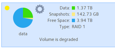

I was in the middle of rewiring a PoE security system and let it go until I got the job finished two- three days ago.  The NAS has continued to run and data is  accessible,  however with the drive in drive 2 throwing a failed error I am sure my  redundancy is gone as disk to 2  is obviously bad. The DRIVES in the NAS are a pair of Seagate 6TB IronWolf Pro v11 7200RPM SATA 6Gb/s 256MB Cache 3.5-Inch NAS Hard Disk Drive (ST6000NE0023)'s   In looking at the NAS control panel the diagrams ares as shown below
I must say I am a bit miffed as to why the one Graphic indicates RAID 1 and the Main Graphiv from the top left indicates X RAID  but I digress I m not sure it matters of if it is in effect X RAID I really don't recall how I originally configured it .
    X-RAID is application software that Netgear layers on top of standard RAID.  In your case, the system is set up to use RAID 1, and X-RAID is also enabled.
    If X-RAID was not enabled, there would be no green stripe through the control.
