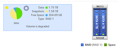

Failed Drive Replaced, Recync Complete, But Volume Is Still Degraded
My RN312 has been working fine for many years.  Just recently, one of the 4TB WD Black drives indicated a failure.  I removed the failed drive and replaced it with a newer 4TB WD Black drive with the same specs.
Disk: Disk Model:WDC WD4003FZEX-00Z4SA0 Serial:WD-WCC130839778 was removed from Channel 2 of the head unit.
Disk: Disk Model:WDC WD4003FZEX-00Z4SA0 Serial:WD-WCC5D1NFAZE8 was added to Channel 2 of the head unit.
After the new drive appeared in the console, I was able to wipe it, then start the resync process:
Volume: Resyncing started for Volume data.
After about 9 hours, I got these messages in the log:
Volume: Volume data is Degraded.
Volume: The resync operation finished on volume data. However, the volume is still degraded.
Disk: Disk in channel 2 (Internal) changed state from RESYNC to ONLINE.
I decided to reboot the system to see if that would clean up whatever went wrong.  It immediately started resyncing again:
System: The system is rebooting.
System: Alert message failed to send.
System: ReadyNASOS background service started.
Then, about 11 hours later, I got this:
At this time, the console (and log messages) show that the volume is still degraded, after two resync attempts, although both drives show ONLINE.
Suggestions?

  • Sounds like your new drive is bad.  Best thing to do it attach it to a PC (via SATA or a USB to SATA adapter) and test it with vendor tools.
    If it tests good, then test the old one, too.  If it also tests good, the problem is in the NAS.

        FYI -- I had no problems formatting the drive on a computer.  The second 4TB drive (also removed from the RN516 when upgraded) was blanked, formatted, and added to the array, but it resulted in the exact same result -- the resync completed and the drive was marked ONLINE, but the volume still shows as degraded.  Additional suggestions?
