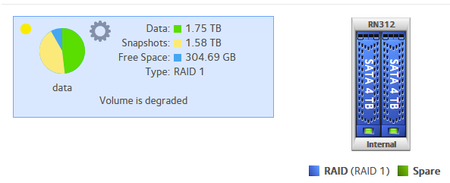

Failed Drive Replaced, Recync Complete, But Volume Is Still Degraded
My RN312 has been working fine for many years. Just recently, one of the 4TB WD Black drives indicated a failure. I removed the failed drive and replaced it with a newer 4TB WD Black drive with the...

A majority of the data on this volume is a backup of other data from other devices that is refreshed on an automated schedule via Beyond Compare. As such, just about everything does exist elsewhere. I've learned my lessons over the years -- before I did ANYTHING with this system, I copied all of the data off of the volume to my new Synology NAS, so I have no fear of losing anything.
It is possible that a file has been mangled with the lost block, but that is always a risk. Beyond Compare can also perform a byte-wise comparison if I want, which can identify and fix a damaged file if it is truly a backup in the first place, and fix that up, too.
I will try the disk tests to see if that buys me anything. The SMART data shows that the last failure on that drive was in 2022, but that it is showing 53 pending sectors
2022-05-06 00:45:58 WDC WD4003FZEX-00Z4S WD-WCC5D0015414 0 0 0 -1 -1 53 53 0
Conversely, the "failed" drive was showing 548 pending sectors before it choked to death on 03/17/2024.
To that end, do you recommend simply replacing BOTH drives at the same time, and reinitializing the RAID? I hesitate to do that because I'm not sure where the RN312 keeps its brain. I don't want to have to reset the OS itself, and I have some special security rights set up for a few of the shares to allow its use as backup and as a FTP upload target while preventing abuse. Is there a step-by-step guide to replacing both drives at once to help limit the potential issues?

- BtrieveBillMay 20, 2024Aspirant
Well, the excitement is now over. After agonizing over it for a while, I really didn't want to start all over, since the Plex software wouldn't be able to reinstall with the new firmware. (stupid me for patching.) So, I opted to pull the "good" drive and replace it with the failed-sync "bad" drive, just to see what would happen. Since the system partition was good, it started up and maintained all of my settings, as you foretold, but the volume was unusable. No worry -- I had a backup! So I purged the "bad" volume, recreated a new one (adding a second replacement drive in the process), and created a new RAID array. Am now in the process of copying my data back and resyncing the volume. Will know more in 20-30 hours!
