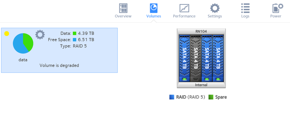

On sunday, I woke to the NAS making a loud whirring noise and the following errors showed on the system when I checked the logs:
Apr 12, 2025 08:26:32 AM Disk: Detected increasing reallocated sector count: [2123] on disk 2 (Internal)
Apr 12, 2025 08:19:59 AM Disk: Detected increasing ATA error count: [1536] on disk 2 (Internal)
When viewing the SMART log, the ATA errors date back to the 31 December 2024 and numbers increasing since then.
When I look in overview it says Degraded. I gather this means the drive itself is old and needs replacing (and fingers crossed it shouldn't be a problem with the NAS connection to the drive).
In the admin page tab volumes, Disk 1, 3 and 4 are blue with green status lights. Disk 2 is completely greyed out with no light.
In performance, Disk 2 is also greyed out and temperature is 0.
See screenshots below.
    Your RAID array has single-disk redundancy.  That means you can still get to your data even if one drive fails.
    The "degraded" status is for the full volume of four disks, and it means that the NAS has already decided that disk 2 has failed, and has stopped using it.  So your data is definitely at risk, since if there is a problem with another drive you will lose all your files.
    JuneWinters wrote:
    1. Forum discussions I have seen say to simply switch out the failed disk and replace it. However, is any further backup required first?
    Devices can fail at any time, and your data is particularly vulnerable right now.  Netgear recommends backing up your data before manipulating disks, and I agree with that guidance.  However, you don't want to delay the replacement either.  So order the replacement disk (another Ironwolf is fine), and start backing up while you wait.  You might also order a USB drive to give you space to back up.
    You should prioritize unique content (documents, family photos and videos) that cannot be replaced.   You might already have enough storage (thumb drives, or PC disk space) to hold the personal files.  If not, you could purchase cloud storage from Google (or others), and copy the files to Google Drive (or equivalent).  2 TB of storage costs about $10/month.  2 TB won't be enough to copy all your files, but likely will be enough for the personal files.
    Then back up media (music, movies, etc). after the personal files are safe.

    The reallocated sectors are definitely pointing towards the disk, and not the NAS.  If you can connect the disk to a Windows PC (with SATA or a USB adapter/dock), you could test it with Seatools to confirm.
