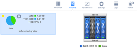

ReadyNAS RN104 Drive degraded, ATA error
Hi all, I have a ReadyNAS RN104 that it seems has a drive that is going kaput. I thought I had alerts set up but seems they were going to an old email address and so I haven't been getting the 4 ...
- Apr 15, 2025
JuneWinters wrote:
When I look in overview it says Degraded. I gather this means the drive itself is old and needs replacing (and fingers crossed it shouldn't be a problem with the NAS connection to the drive).
Your RAID array has single-disk redundancy. That means you can still get to your data even if one drive fails.
The "degraded" status is for the full volume of four disks, and it means that the NAS has already decided that disk 2 has failed, and has stopped using it. So your data is definitely at risk, since if there is a problem with another drive you will lose all your files.

StephenB
Apr 15, 2025Guru - Experienced User

- SandsharkApr 16, 2025Sensei
StephenB wrote:I recommend hot-swapping the drive (NAS running when you remove it and insert the new one). But you do need to be very careful to remove the correct drive, and leave the others connected. So if you aren't certain you can do that successfully, then power down the NAS, and remove disk 2 first. After that, you can power up - the NAS will still show a degraded status. Then hot-insert the replacement.
Also, don't power cycle the NAS with the bad drive installed. If the drive happens to come up for a short period if time when you re-boot, the NAS my try to re-sync it into the volume, which is going to fail. And when it fails, you can lose the entire volume. If you've powered it down already, remove the bad drive before you power it up, verify your data is still intact when powered back on, then install the new drive with power still on.

- SandsharkApr 17, 2025Sensei
If you lose another drive before the re-sync completes, your volume will be lost. If all of your drives are the same age, then another failing is a larger risk. That risk is especially high during a RAID sync because it puts a lot of stress on the drives.
But to properly assess your risk, you have to evaluate the consequence of losing the volume. If there is data on it that exists nowhere else (which is always a bad idea) and whose loss would be bad (losing all your family photos, for example), then you shouldn't risk it. If everything there is backup itself (so it exists elsewhere), then you can always recover from the original source, though that will likely take you some time, making the risk lower.
