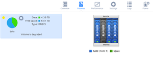

ReadyNAS RN104 Drive degraded, ATA error
Hi all, I have a ReadyNAS RN104 that it seems has a drive that is going kaput. I thought I had alerts set up but seems they were going to an old email address and so I haven't been getting the 4 ...
- Apr 15, 2025
JuneWinters wrote:
When I look in overview it says Degraded. I gather this means the drive itself is old and needs replacing (and fingers crossed it shouldn't be a problem with the NAS connection to the drive).
Your RAID array has single-disk redundancy. That means you can still get to your data even if one drive fails.
The "degraded" status is for the full volume of four disks, and it means that the NAS has already decided that disk 2 has failed, and has stopped using it. So your data is definitely at risk, since if there is a problem with another drive you will lose all your files.
