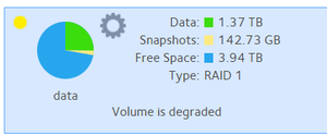

I have an Ready NAS 422 Firmware: 6.10.7 about 4 years old has been running with out issue for close to the entire four years - I recently stumbled across an error message on the Front LCD indicati...

kvz1r wrote:
I must say I am a bit miffed as to why the one Graphic indicates RAID 1 and the Main Graphiv from the top left indicates X RAID but I digress I m not sure it matters of if it is in effect X RAID I really don't recall how I originally configured it .
X-RAID is application software that Netgear layers on top of standard RAID. In your case, the system is set up to use RAID 1, and X-RAID is also enabled.
If X-RAID was not enabled, there would be no green stripe through the control.
