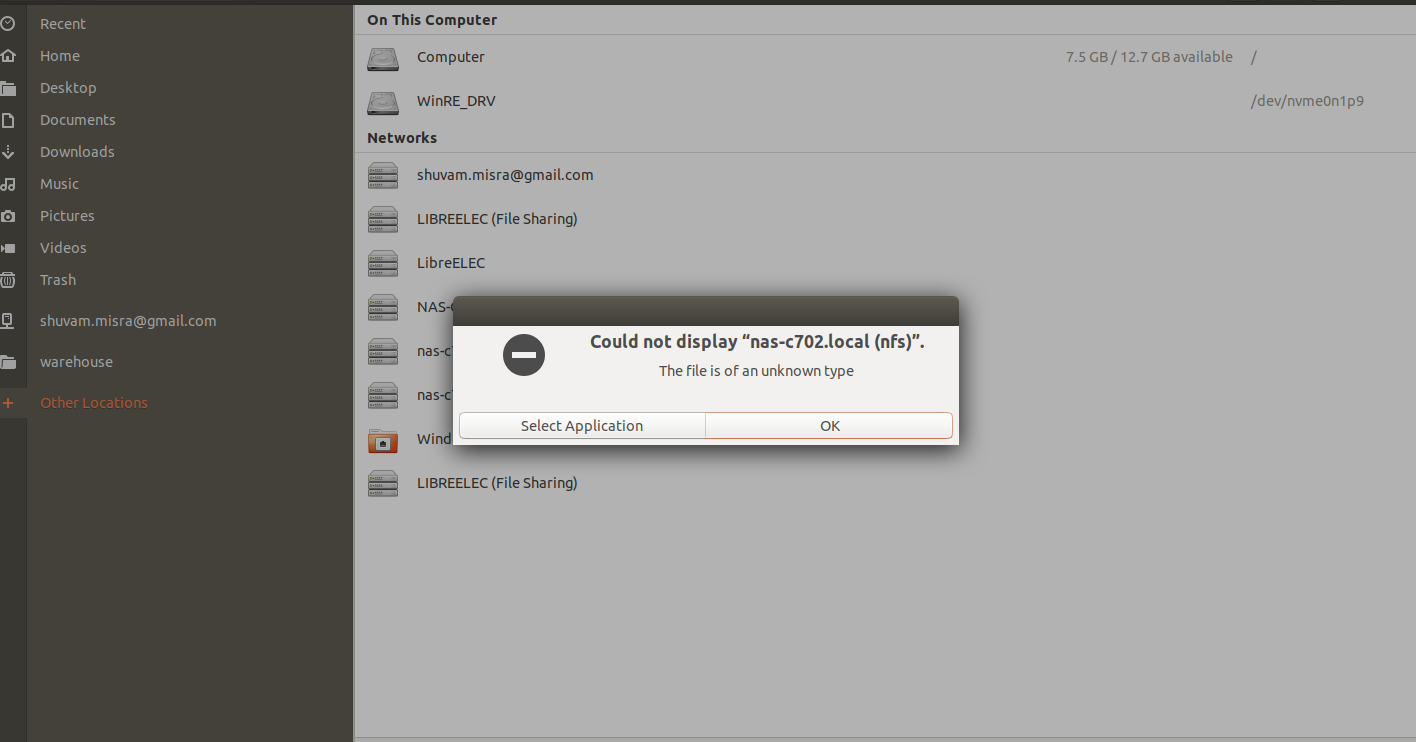

In my Nautilus file browser, when I access "Other locations", I see three entries for my NAS (screenshot attached):
- an all-caps entry NAS-C702
- a lower case entry nas-c702 (AFP) with "AFP" at its end
- a lower case entry, just nas-c702
I don't remember seeing the first of these three 2 days ago when I had last checked. Today, I tried the first one, all-caps, and I could access the shared area on the NAS.
The second area I have always ignored, since it says "AFP" (which is an Apple protocol, I believe).
The third one is the one which I used to use: nas-c702. It had stopped working a few days ago, and it's not working even now.

Screenshot of what I see when I try to access the NAS using the third entry in my file browser. This error has been consistent for the last 3+ days.
