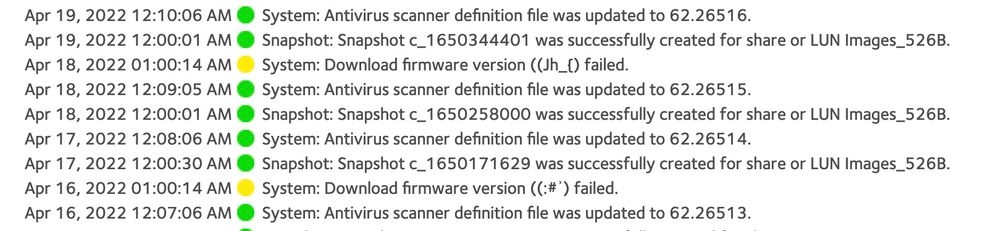

I have 2 Readynas 526X units. They are identical, 6 - 6TB HD's running Raid 6. In the log one unit is giving me an error saying the firmware download failed, the other one is not. The version # of the update looks a bit strange, I'm concerned there is something going on here that shouldn't be. I'll add a screenshot section of the log, if anyone has any ideas / advice I would like to hear them.

Yes, and if I click check on updates both systems respond with my system is currently running the latest Firmware. I was concerned that something has gotten installed on my system that was trying to download a virus/ransomeware etc... This is only occurring on one of the 526's.

- StephenBGuru - Experienced User
Something isn't right, but it seems unlikely that ransomware would log anything.
It looks like the RN526 is set to auto-update - maybe turn that off for now. Then see if you get the sane error at 1 am tomorrow.
