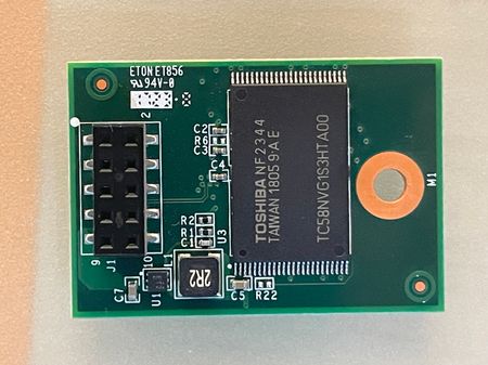

For those interested: the daughter board of 628X (maybe others as well) is a 10-pin USB
schumaku
Oct 14, 2023Guru - Experienced User
No rocket science: A standard, Industrial Grade USB Disk On Module (DOM) - as discussed earlier.
tigerten
Oct 14, 2023Luminary
I read it somewhere it is a 9-pin. Not sure what the 10th is for. The 10-pin is not as widely available as the 9-pin ones.
- schumakuOct 14, 2023Guru - Experienced User
New to me there are USB DOMs with 9-pin ... does not make to much sense as all I'm aware of are made of 0.1" 5x2 pin headers. Fun fact, only four wires are used as it's naked USB 8-)
Guessing a little bit more? One of the 2x5 is used as an index (pin or non-pin).
- tigertenOct 14, 2023Luminary
on the 9-pin model, the 9th pin, which is actually the 10th, has no function except to direct the orientation. Now th eproblem arise with full 10-pin? ho would one orient the plug in?
- schumakuOct 15, 2023Guru - Experienced User
Ideally, here are markings on the main PCB, giving an idea which way round you need to plug the DOM.
Sometimes you find screen print markings for VBUS (USB input voltage, typically 5V) or similar - on both the embedded system PCB and the DOM indicating the Vbus or Vcc pin.
On your image in the opening post, there is a white marks indicating the pin 1 btw. on both devices (!!!)
Unless you shift the 2x5 around, you can't kill neither the USB(!) Flash DOM - either it is recognized and works, or you plugged it the wrong way round.
For the other users, a PCB and a DOM are don't-touch-area if they don't know what they do - as written in the holy books.
For the readers going to this complete post: It's possible to convert USB Flash sticks by adding a 0.1 stepped 2x5 connector. Avoid soldering the other (unused) side pins to avoid the short circuit situation if plugged the wrong way round. And never forget there is a hot end on a soldering iron please.
