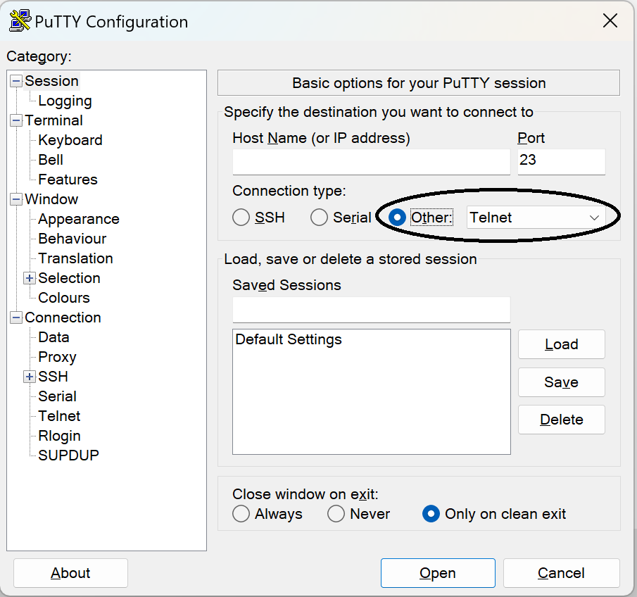

I may have run into a noob problem right off the bat though.
In normal mode I can Telnet into the NAS just fine using the IP address shown on the NAS with the standard port 22.
In Debug Mode this no longer works.
I enter the IP address as shown on the NAS but I get a fatal Putty error "Network error: Connection refused".
It refuses it, so the address is correct, the NAS just rejects the attempt.
The NAS also shows DebugMode 63334 in brackets on the screen, figuring that may be the port, but it doesn't work either.
I may need the slightest of nudges to get me in so I can br.. fix stuff.

- StephenBAug 05, 2024Guru - Experienced User
No you can't. The NAS won't accept telnet connections in the normal mode. You are selecting ssh in the putty dialog.
You need to select "other", and then choose "telnet" in the pulldown.
- tijgertAug 06, 2024Guide
Currently backing up the NAS first, so it'll take a day or two before I can continue. I shall return!
