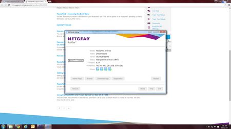

Hello Guys. . I have got one readynas device. WHen i was trying to connect the server i am geting management service is offline . So i am not able to do any setup here. Even i have tried ...

Ah that is probably it.
ReadyNAS OS 6.2.x does not support volumes > 16TB.
If you want a volume > 16TB you should run 6.4.0 beta. I would suggest doing a factory default after the upgrade.

If there is no data loss, you can
(a) test the disks with vendor tools on a PC (seatools for seagate, lifeguard for western digital). Unformat the drives (for instance with windows disk manager) or zero them (with either of the vendor tools) while you are at it.
(b) insert one of drives (after testing) into the 2120, and see if that does the proper factory install. If it does, update the firmware to the current production level.
How many drives are you installing, and what model?

i have got 4 drives. 8TB .
Model no is 2120. can you tell me from the initial steps ? because i dont have any idea about it.
