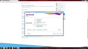

management service is offline readynas
Hello Guys. . I have got one readynas device. WHen i was trying to connect the server i am geting management service is offline . So i am not able to do any setup here. Even i have tried ...

Yeah . . Its a new device . . But there is no support here . . I am in Saudi Arabia. . I am not able to get the online help from Netgear.
