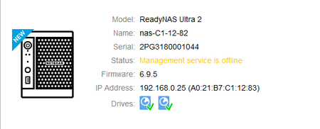

I have now restarted the NAS as you asked for it. It went to the same status: Power button is blinking blue and activity LED is blinking from time to time.
Raidar are showing the same status as mentioned: "Management Service is offline".
thx
See if the RAIDar function to download logs is successful.
You could try another factory default from the boot menu.

Hi StephenB,
Yes, I did upgrade the RAM from 1 to 2 GB two years ago when I upgraded from 2x 2TB to 2x 4TB.
thx
thx

I switched off twice my NAS.
I tried to proceed a manuall "factory default".
After few minutes, I could follow the starting steps of the NAS.
Everything is now on green. I will wait for the sync process to be finalize.
Restart the NAS properly and try an update of the new OS system.
