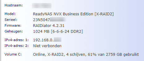

- haka1311Mar 04, 2019Aspirant
i did enable SMBv1 in Windows settings.
the model is RNDX4000 says the label see also attachment
- StephenBMar 04, 2019Guru - Experienced User
haka1311 wrote:the model is RNDX4000 says the label see also attachment
Ok. That's an NVX - quite different from the NV+.
