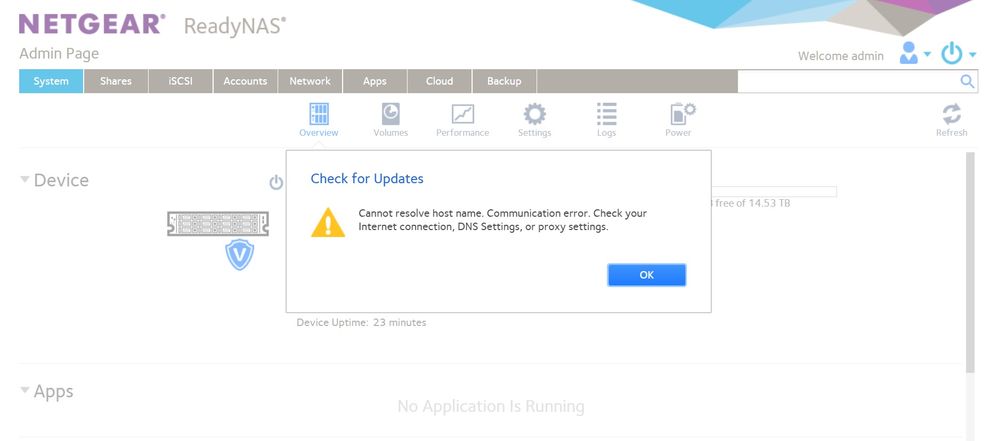

Ready Nas 3312 not showing Internet
I have installed Ready Nas 3312 and its connected with internet using LAN but its showing error while updating as given below:
All other devices conneted with the same switch are getting internet availability. If the same cable connected with ready nas is connected with other devices, the internet is functional.
Please help to resolve this issue.
    Updating? Netgear has stopped any ReadyNAS related services, including automatic updates, a long time ago.
  • StephenB's avatar
    StephenB
    "Internet availability" is not the problem.  That said, the NAS uses a deprecated version of Linux, and is no longer getting security updates.  So you should be careful about enabling any over-the-internet access to the NAS.
    As schumaku​ says, you are seeing this because Netgear shut down the ReadyNAS update server.  There is no fix.
  • So you just set up this NAS?  It sounds like you purchased a used unit without knowing much about it.  So before you continue, you need to understand that the ReadyNAS line has not had a meaningful OS update in close to 10 years and all support has been stopped.  I personally do not recommend that anyone jump aboard the ReadyNAS ship at this point.  Those already on this sinking ship need not abandon right away -- there are ways to work around issues -- but do need to be thinking of where they will go should those work-arounds become too cumbersome or even non-workable.  Others are better served by going to an alternative now.
