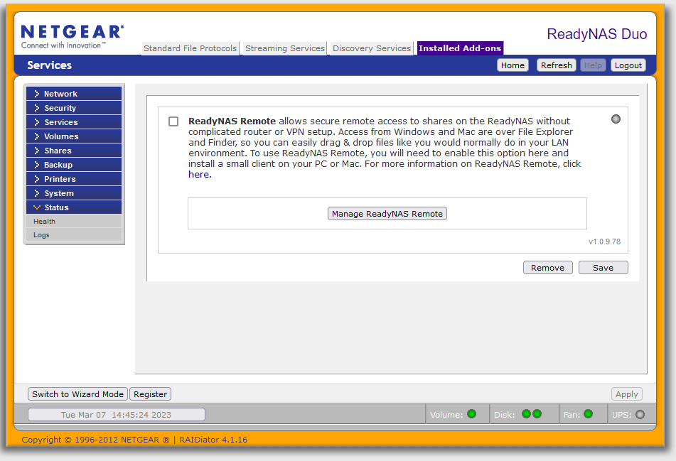

You are looking at the wrong screen. Ready Remote hasn't worked for a very long time.

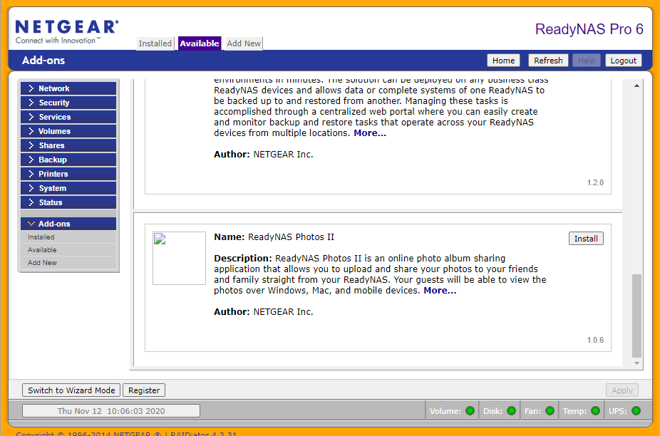

You want to open up Status and then Add-ons in the left pane menu, and then choose "add new" from the top.

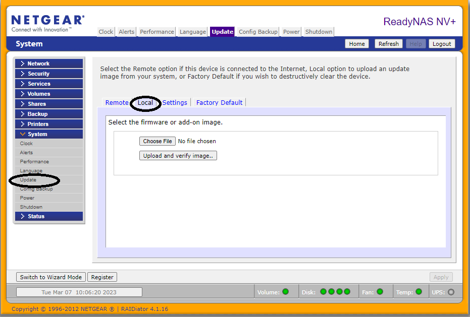

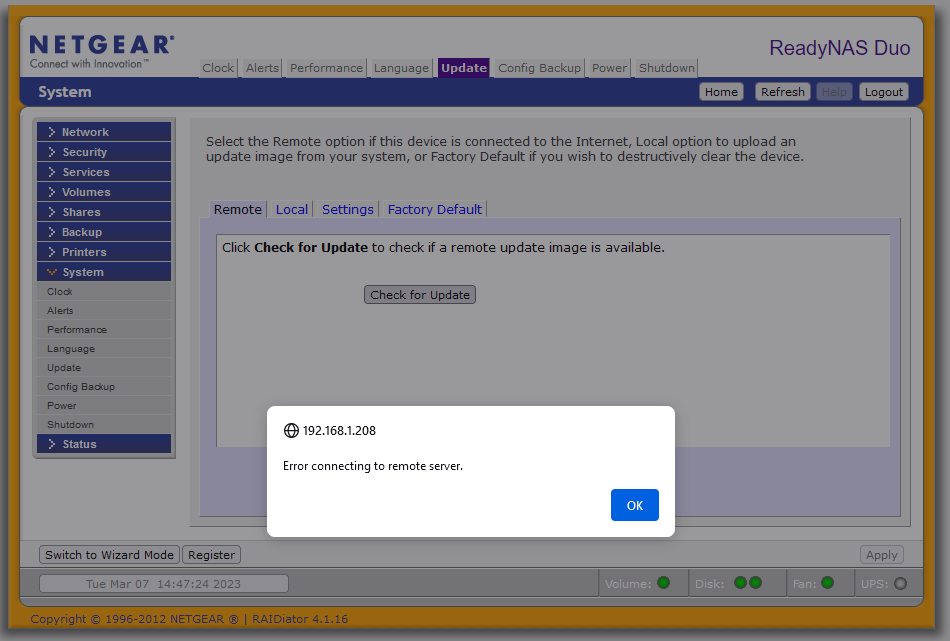

Yes, it is a bit different. Don't attempt to register or check for updates on the remote tab, as that will give you the "error connecting to remote server" error. If you do get it, then just click ok.
Select
- System
- Update
From the left pane.
Then select Local at the top.
First you "Choose File", and select the .bin file
Next you click on "Upload and verify image".
