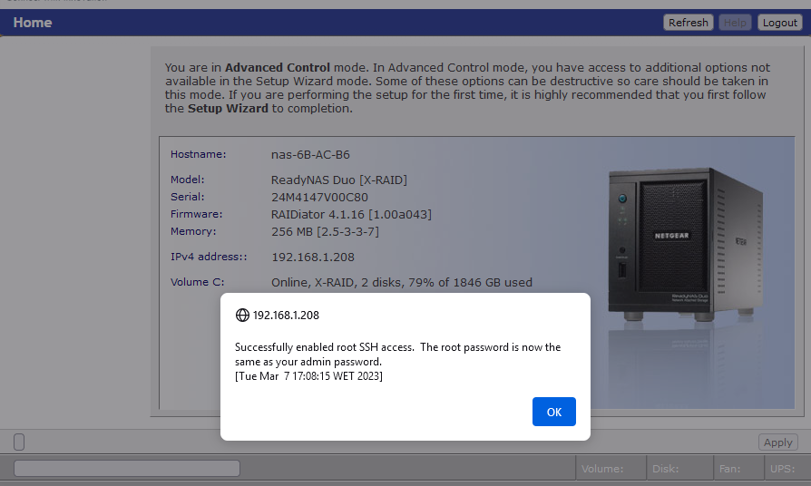

WellingtonBDS
Mar 07, 2023Aspirant
Out of doubt, I installed it once again with success.
On NAS reboot confirms installation
But I still don't have access to the root of the server
C:\WINDOWS\system32>ssh root@192.168.1.208
ssh: connect to host port 22: Connection refused
- StephenBMar 08, 2023Guru - Experienced User
ssh: connect to host port 22: Connection refusedAre you perhaps using the default admin password (netgear1)?
Also, I am wondering if you have internet security software running on the PC. If you do, try disabling it.
- WellingtonBDSMar 08, 2023Aspirant
I'm not using the default password
But since I can't log in, it doesn't ask for a passwordI created new rule in Windows Firewall and
I released port 22 for all protocols
I enabled the ip 192.168.1.208Disabled Avira Antivirus scan and turned off Malware Bites
second try: i disabled the firewall too
I still have access denied on port 22C:\WINDOWS\system32>ssh root@192.168.1.208
ssh: connect to host port 22: Connection refused - StephenBMar 08, 2023Guru - Experienced User
But since I can't log in, it doesn't ask for a passwordI asked because some features are intentionally disabled if you are using the default password.
ssh: connect to host port 22: Connection refusedMaybe try rebooting the NAS, and see if that helps.
But this might be Avira - not sure what package you have, but they offer internet security software, and not just AntiVirus. Was it completely disabled? I don't think malwarebytes will get in the way - I have had the "premium trial" on some of my PCs, and was able to use ssh on them.
Most of these packages have logs, so you could also look at them for any signs that they are blocking the port.
- WellingtonBDSMar 13, 2023Aspirant
Hello Stephen!
I did everything in my power and I couldn't get to the root of the NAS to update
I'm a photographer and I use Duo to store my work (I'm the type that doesn't store it in the cloud), just because of the security of XRaid mode, I don't connect to it via the internet, I use it only as local storage.
So I'll settle for accessing Frontview via old Firefox (I'll save the installation for future needs)
If you have a suggestion for another type of safe file storage, you can suggest
