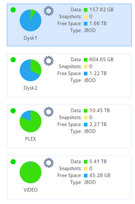

my system looks like this:
and for a start I would like to replace Disk 2 and Video
