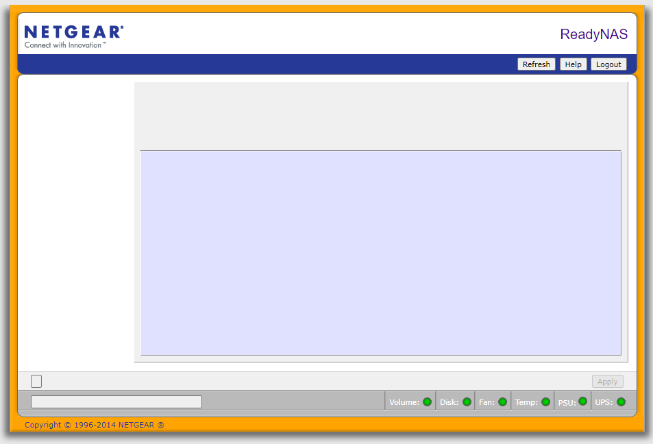

Ah... No sooner did I think I had this thing fixed and it seems I've hit another wall. I can't set the thing up because Frontview gives me absolutely nothing to work with:

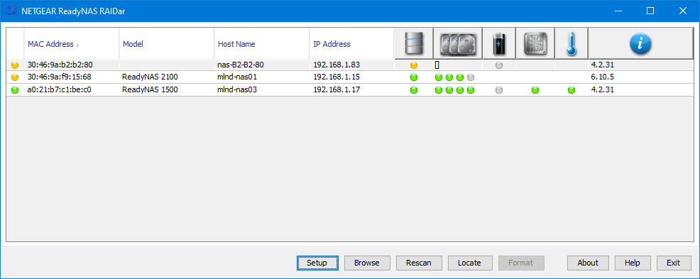

This is what I'm seeing in RAIDAR. The box booting up shows the two disks I have installed, but then it changes to a box. Also, it doesn't seem to know what hardware it's working with at any point:
Now I've done some digging and it seems like the EEPROM has messed up as part of the USB recovery process and that this means I need the intervention of one of the lovely people at Netgear. Thing is, is this going to be doable on such an old bit of kit and, if so, is it going to be expensive?
