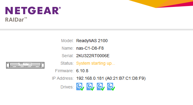

Ok guys, I found a way to upgrade the old 2100 (v1!!) to firmware version 6.10.8:
Everything seems to work well. I will do some tests the next days and then move data to the NAS.
See these guides:https://github.com/ChrisCarini/netgear-readynas-R4toR6/tree/main
https://blog.chriscarini.com/2020/11/upgrading-readynas-ultra-2-from.html
