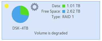

#1 - 4TB OLD: This one is the one you mentioned started failing since 2023 with reallocated and pending sectors.This one used to be in the Flex-Raid with disk #2 (Could have the data pending to backup). NAS would not boot with this drive alone. When booting with disk #2, this disk would not be recognized correctly and power light would blink slowly constantly.
#2 - 4TB New1: This one has the data still pending to back up but files do not show when browsing via admin page.
NAS can boot with this drive alone.
It should have the same data than #1, but no data is available.
This is all that shows when browsing this disk:

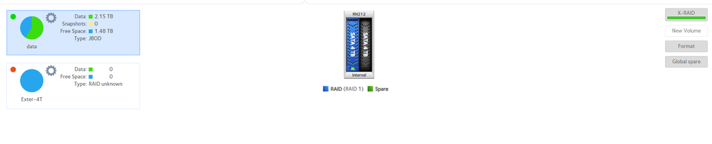

#3 - 6TB: This disk has been backed up already. This is the "data" volume (JBOD) and it boots correctly.
#4 - 4TB New2: This disk has all the data backed up from "#3 - 6TB". (1.6TB of data backed up)

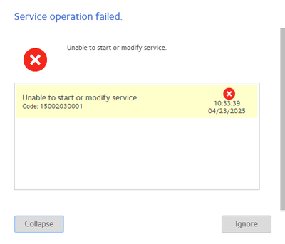

Unfortunately I can't enable SSH:
Same issue has been happening when tried to enable DLNA.
- IhshinronApr 24, 2025Aspirant
StephenB wrote:Try booting up with 6 TB + 4 TB, and see if ssh is (or can be) enabled.
If it is, then try the same steps.
Booting both allowed to enable SSH.

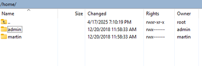

Looks like I've connected via SSH with WinSCP and nothing is showing up:
Both folders there are completely blank. I logged in using the admin user and the "martin" user as well. Same result in both cases.

Are you in the DSK-4TB folder? It looks like you might instead be in the home folder.
Try clicking on the top folder icon (..) to bring you up a level. When you get to <root> at the top, you should see DSK-4TB in the folder list.

Stephen, you are my savior! I'm backing all the data from the 4TB disk that was missing.

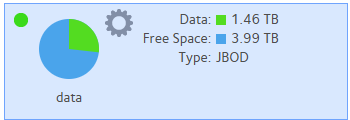

Ok, so I've factory resetted everything with one of the 2 4TB disks. Then moved everything over the network. Then backed that data in the 6TB disk just in case. This is the "data" volume in JBOD.
Now, the original back up disk (the 2nd brand new 4TB disk) was hot-inserted into the NAS and this is the screen I see:
It recognizes the volume already created on that 2nd disk (the one on the right). So what I should do now would be to select that Exter-4TB and hit the "format" button?
From there it will format it (would it ask to remove the disk in slot 1 for security?) and then add it as RAID1 automatically or should I do something else after formatting?
StephenB I'll wait for your response to be sure I'm doing the right thing.

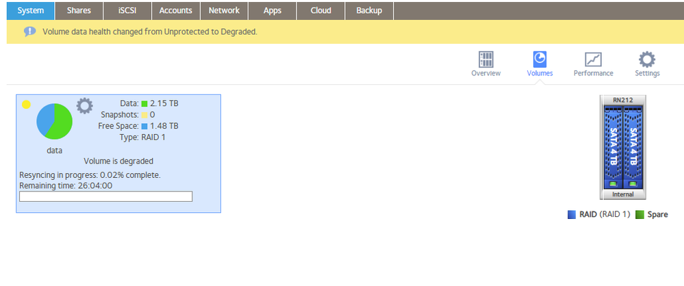

- IhshinronApr 30, 2025Aspirant
OK, I've done that nad it started Resyncing process but it shows a message up top stating "Volume data health changed from Unprotected to Degraded".
Would that go away (back to "healthy")once it finishes resyncing?
- StephenBApr 30, 2025Guru - Experienced User
Ihshinron wrote:OK, I've done that nad it started Resyncing process but it shows a message up top stating "Volume data health changed from Unprotected to Degraded".
That is normal during a sync, and it will change when the sync finishes.
