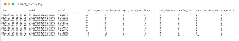

mdgm wrote:You can download the logs and look at smart_history.log. That will tell you if there were any warning signs from SMART stats that the disk had problems and when.
aha! So this is interesting…
that one with errors is in fact the problem drive. You'd think the system would notify me; it sends me emails every time it farts, but not when it has a failing drive? Grrr

PhotoJoseph wrote:that one with errors is in fact the problem drive. You'd think the system would notify me; it sends me emails every time it farts, but not when it has a failing drive? Grrr
It can be subjective when to replace a disk, though a sudden increase from 0 to 48 reallocated sectors is something worth paying attention to and any current pending sectors suggests a disk is failing.
