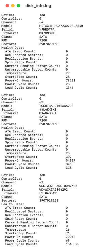

Does ANYone have any insight as to WHY does this chassis want to assign/persists in assigning NEGATIVE disk channel numbers? (See example below).

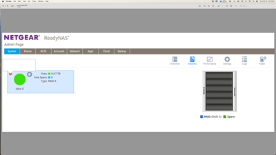

IF I insert six blanked drives (all volumes erased/removed in windows) it will start and show NOTHING on the Volumes tab in the GUI but the Volume size is correct (Six x 2TB drives) See Below.

I have TRIED to scan logs for answers... (That is where the Negative Disc Channel thing shows up as above)

THEN all six drives showed up on the GUI. Correct sizes, ALL working well and GUI showing all details.
Thinking I had FIXED it, (or somehow reset the log/journal/setting assigning the negative disc channel numbers) I thought I would Factory Reset the 426... NOPE, bad idea.
It immediately goes back to NO drives being seen in the GUI (totally blank on the volumes page) no details available when hovering the mouse over the drive slots.
