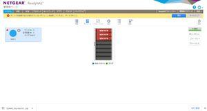

ReadyNAS 428: Error in recognizing 5 out of 8 HDDs with RAID6
I was building RAID6 with 8 * 10TB HDDs, but when I checked it, only 3 were recognized as shown in the attached figure, and the other disks were not recognized. dmesg log sd 4:0:0:0: [sda] 19532...

ishi wrote:
Would you please teach me ideas of how to recover ?
Do you have data to recover? Or is the issue just that the initial install failed to build the RAID array?
ishi wrote:
It is unlikely that 5 HDDs will be damaged at one time, so I think problem is occur on the chassis side.
Could well be. If you are the original purchaser, the NAS should still be covered by Netgear's 5-year warranty. You could go into my.netgear.com and request a warranty replacement.
However, I would first test the 5 disks with vendor tools (WD's Dashboard or Seagate's Seatools). If this were all shipped together, then they might have been damaged in shipment.

Hi StephenB ,
Thank you for reply.
Yes, we have data to recover (almost 50TB).
Unfortunately, this ReadyNAS is old and maker 3-year warranty is already expired.
So Japan NETGEAR support introduce me this community.
Thank you for advice. As you mentioned, we can distinguish disk error with readynas box problem using Western Digital Dashboard.
Do you mean it seems difficult to recover data in this situation ?
Thanks again,
ishi
