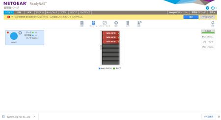

ReadyNAS 428: Error in recognizing 5 out of 8 HDDs with RAID6
I was building RAID6 with 8 * 10TB HDDs, but when I checked it, only 3 were recognized as shown in the attached figure, and the other disks were not recognized. dmesg log sd 4:0:0:0: [sda] 19532...

It sounds like it is probably a hardware issue, but here is the best way to test it:
- Remove all the drives, labeling them according to the slot they came from (so they can be returned their later).
- Install a spare drive (of any size, but not containing any data you care about) into bay one and create a volume.
- Power down and move the drive to one of the "dead" bays.
- Power up and see if the volume is recognized.
- Repeat for all "dead" bays.
If the drive and its volume are not recognized in the "dead" bays by itself, it is definitely a hardware issue.
If you cannot get a warranty replacement, then finding an 8-bay replacement is going to be tough. Other options are rack-mount 12-bay models. If your volume is RAID6, which it would be using default XRAID, you can also use a 6-bay unit. You'll lose redundancy, but that would likely be fine for data recovery. Booting in read-only mode would help keep anything bad from happening while you have no redundancy.
Note that legacy NAS converted to OS6 will usually work for this, but the rack-mount 3200 and 4200V1 are excluded for you since only 4 of the 12 slots will support drives >2TB. Of the legacy rack-mount units, only the RN4200V2 or a ReadyData RD5200 converted to OS6 (which is much more complicated than updating legacy ReadyNAS) will work.

If you can't find a replacement chassis (RN428, RN528, RN628, or perhaps an RR3312 rackmount), then you'll need a way to connect the disks to a Windows or Linux PC. An 8-bay USB chassis is one way you can do that.
From there you can attempt to mount the RAID array. mdadm and btrfs are needed - they are normally linux tools, but there are open-source beta-level software packages for Windows available on github. Another option for extracting data is to use RAID recovery software that supports BTRFS. ReclaiMe is one package that several folks here have used with success.
