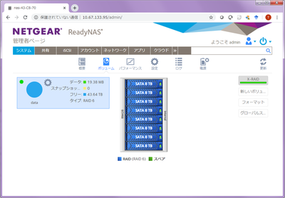

ReadyNAS 428: Error in recognizing 5 out of 8 HDDs with RAID6
I was building RAID6 with 8 * 10TB HDDs, but when I checked it, only 3 were recognized as shown in the attached figure, and the other disks were not recognized. dmesg log sd 4:0:0:0: [sda] 19532...

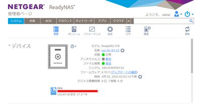

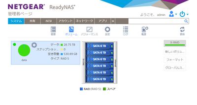

Unfortunately this box was already used by another user.But I found another ReadyNAS316 box which OS is 6.10.7. This is old model than RN428.
Do you mean this RN316 is "legacy NAS converted to OS6" ? If so I will try to use this with "read-only mode".Kind Regards,
Do you mean this RN316 is "legacy NAS converted to OS6" ?No, the RN316 is a native OS-6 platform.
There are some older ReadyNAS (Pro and Ultra models) that were designed for 4.2.x firmware, but can be converted to run OS-6. We call those "legacy".
- SandsharkApr 02, 2022Sensei
Thee 316 should work to recover your data, assuming the problem is the hardware of the 428 and the volume was not damaged when the hardware failed. But testing the bays of the 428 really should come first. If there is no hardware problem, you are better off leaving the volume intact and seeing about complete data recovery instead of separating 6 drives for use in another system, which won't help if the problem is not the NAS hardware.
