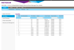

readynas 626x keeps downgrading the 10Gbps LAN port to 1gb that i have been using and have been since new two years plus Readynas firmware 6.10.6 connected to Netgear XS512EM switch connected to Net...

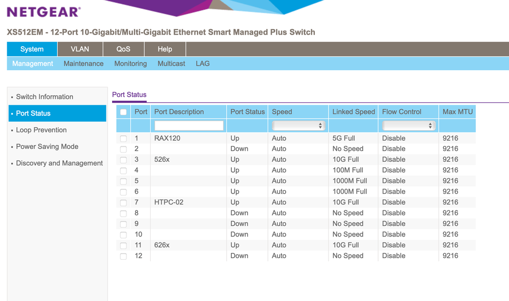

- pgjscottieukFeb 09, 2022Guide
To my knowledge neithe nas units support multigig negoitiation
Both my nas units and my htpc with a 10gb card are connected to the the switch XS512EM multigig then the switch is connected to the rax120 router as i had previous said i have been running it like this for more than two years without problem
you mention setting the speed manually on the nas please can you tell me how to do this
- StephenBFeb 09, 2022Guru - Experienced User
I don't have that particular switch, but from your picture it looks like you select the port on the left, and then select the speed from the pulldown (changing Auto to the speed you want).
Thank you for your reply i have never made any settings in the switch just used as plug n play do you mean the QOS settings if i play with those will it upset the other things a knock on effect i did move the 626 port further along to see if it made a difference as has happened before after unplugging and plugging back in it is back up to 10gb
No, I do not mean the QOS settings. I am talking about the screen above. You should be able to tell the switch that the NAS ports are always 10G Full.
