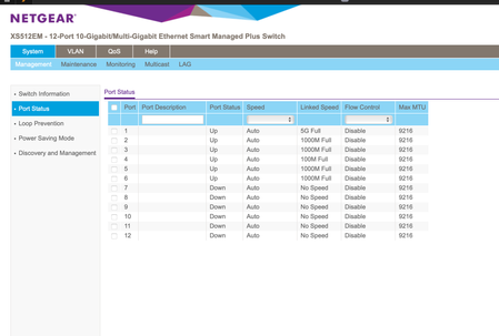

readynas 626x keeps downgrading the 10Gbps LAN port to 1gb that i have been using and have been since new two years plus Readynas firmware 6.10.6 connected to Netgear XS512EM switch connected to Net...

Readynas firmware 6.10.6 connected to Netgear XS512EM switch connected to Netgear RAX120 router multigig port at 5GB
I didn't think the 526 and 626 supported multigig negotiation.
Have you tried setting the speed for the port to 10 gigabit manually?

Both my nas units and my htpc with a 10gb card are connected to the the switch XS512EM multigig then the switch is connected to the rax120 router as i had previous said i have been running it like this for more than two years without problem
you mention setting the speed manually on the nas please can you tell me how to do this
