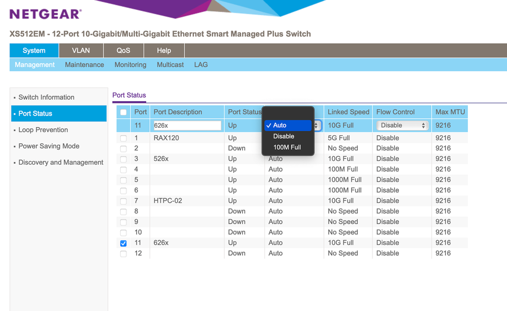

Feb 09, 2022Guru - Experienced User
I don't have that particular switch, but from your picture it looks like you select the port on the left, and then select the speed from the pulldown (changing Auto to the speed you want).

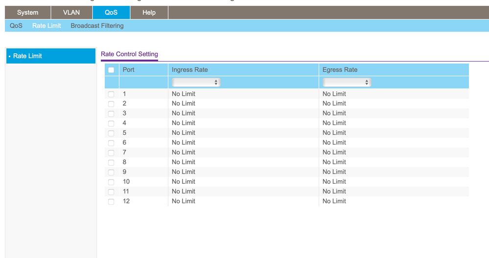

- pgjscottieukFeb 09, 2022Guide
Thank you for your reply i have never made any settings in the switch just used as plug n play do you mean the QOS settings if i play with those will it upset the other things a knock on effect i did move the 626 port further along to see if it made a difference as has happened before after unplugging and plugging back in it is back up to 10gb
- StephenBFeb 09, 2022Guru - Experienced User
No, I do not mean the QOS settings. I am talking about the screen above. You should be able to tell the switch that the NAS ports are always 10G Full.
Hi these are the only options from that drop down menu but it would seem thta perhaps things can be altered here i don't know
