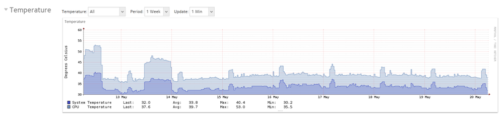

        What does your temperature graph look like? FWIW, here's mine (526x - using the balanced fan setting):
        As you can see, the temps will vary depending on activity, and that of course will affect the fans.  I upgraded two disks a week ago (and you can see the higher temps at the very beginning of the graph when the second one was resyncing).  On May 13th I was running rsync to transfer about 3 TB of data to another NAS.  The small daily spikes after that are when the daily backups run.
        With little/no activity the fan runs at about 860 rpm.
