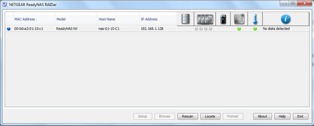

I got the replacement ReadyNAS NV from EBay. It is powered up and I can see it on the network with Raidar 4.3.8.
I have an old SATA 80GB HDD that I have installed in the ReadyNAS drive holster, installed it and started up the ReadyNAS. The blue light is blinking slowly indicating:
Background task active A lengthy background task such as a system update is in progress. I tried to browse the ReadyNAS IP address 192.168.1.128, but got no reply.
What is FrontView? Is Frontview a part of Raidar?
In Raidar, the setup and browse buttons were dimmed out when there was no disk installed as seen in the pic below. They are still dimmed now as the NAS works on the inserted 80GB scrap drive, so I cannot yet see any details about the new NAS.
I have the three (250GB) drives of my RAID array marked in order so I can install them later. But only after I upgrade the NAS to latest software, and test each slot with the scrap disk.
Thanks for any assistance getting my NAS back up and running.
