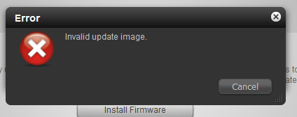

I have tried to updating to: ReadyNASOS-6.10.8-arm
but when I try and update I get the following error pop up:
I am assuming 5.3.13 is the latest available firmware for my NAS?
Correct, your NAS isn't capable of running OS-6.
