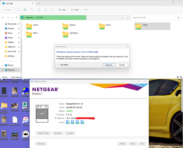

Through Raidar, I can access some of the file locations but most are showing errors and the ones I can access contain nothing:
FWIW, your screenshots are too small to read the text.
What happens if you open CMD on the PC and enter this:
net use * /del /y
net use t: \\nas-ip-address\c /u:admin nas-admin-password
using the real NAS IP address and NAS admin password of course.
Be careful on the typing (paying particular attention to the two different slashes). Note the commands need to be entered on separate lines.

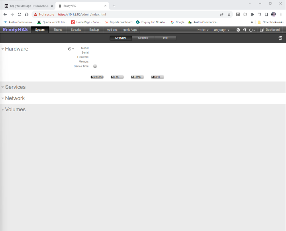

Thank you,
Its now accessible via chrome.

The comment from Sandshark reg "Do you have anonymous access enabled on the NAS" has rectified the files not being accessible via file explorer, however its looks to be wiped as i cant see any of my files etc?
It also worth noting that when I try to copy and paste a file into one of the folders it does noting and when I try to drag and drop a file into one of the NAS folders and red cross circle is shown and tile isn't dragged in.

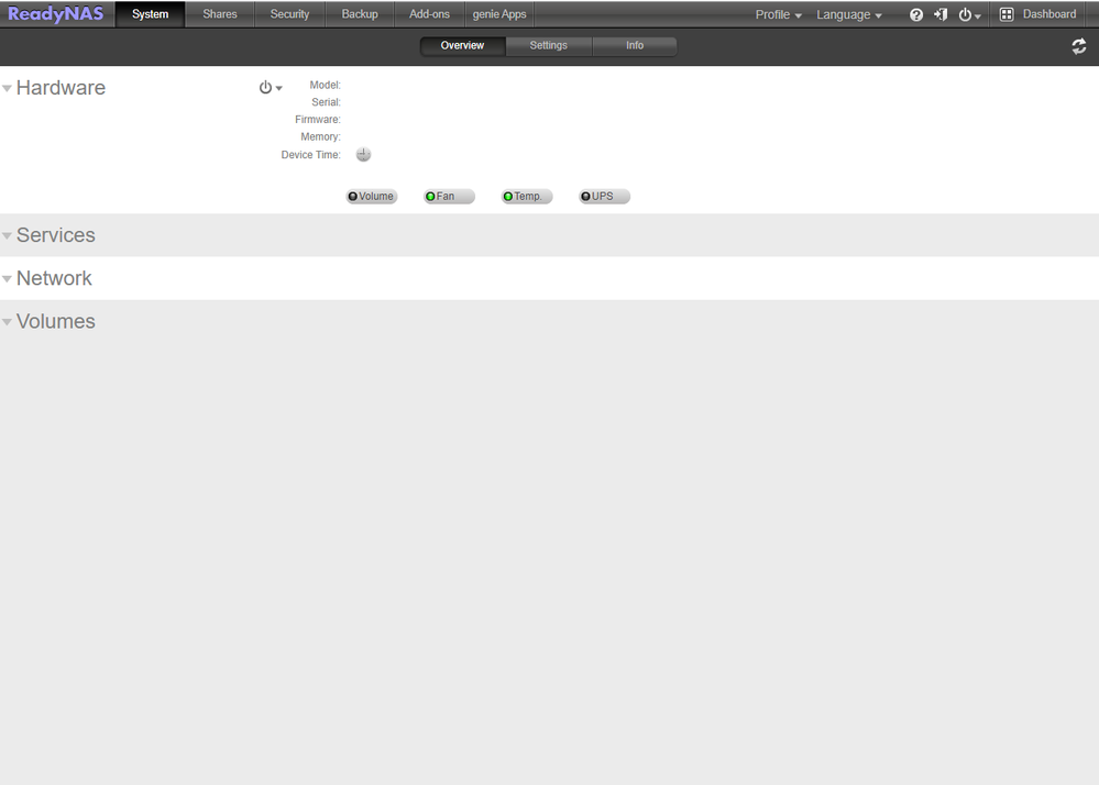

Not sure if this is worth mentioning but under overview page, there no info in hardware/services/network/volumes.
If I install a USB stick in the front port of the NAS then that does appear as a volume.

Please make sure the size is set to large when you post your screen shots. The 400x286 you are posting now makes them completely useless.

C:\Windows\System32>net view \\10.1.2.80
Shared resources at \\10.1.2.80nas-BE-6F-4D-02
Share name Type Used as Comment
admin Disk Home directory of admin
backup Disk Backup Share
home Disk Private user folders
media Disk Media Server Share
Music Disk Itunes Music
The command completed successfully.

I am thinking there is something wrong with the volume, as you really shouldn't see a blank volume status. Have you downloaded the full log zip file? I don't have an NV+ v2, but I would be willing to look at the logs - send a download link via private message (PM), don't post it publicly. You send a PM using the envelope icon in the upper right of the forum page.
