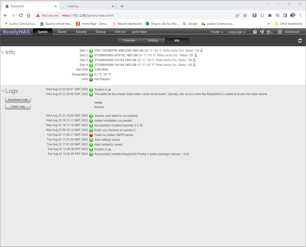

I think its worth noting that that in the info screen is it is showing an issue with shares?

I am thinking that earlier you were looking at the NAS ReadyDLNA server, and that Pictures might not actually be a share on your NAS.
The error on the logs screen is about the SMTP (email) server. Whatever setup you have for email alerts is not configured correctly.

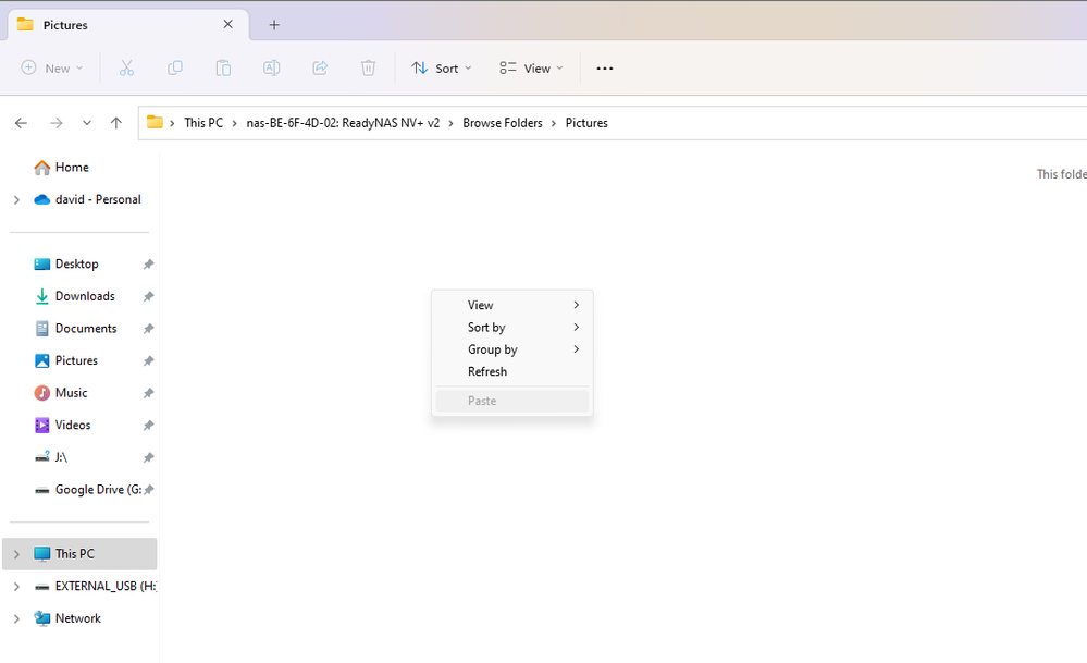

I did input the cmd line as Stephen and mentioned and when navigating via the browse button in raidair it popped asking for credentials and now gives me access to upload files etc as well as more folders be visible compared to via DNS route.

net use z: \\nas-BE-6F-4D-02\media\Pictures /u:admin passwordYour second windows explorer screenshot is actually showing the ReadyDLNA media server. That is only for playback of media, there isn't any write access. If you aren't using DLNA to play the media on the NAS (for instance on a smart TV), then I recommend that you disable the DLNA service in the dashboard. That will remove the DLNA server from your network locations.
