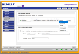

@StephenB Thanks! I left it alone long enough to have it finally show the share, but it still wouldn't allow me to get to test connection option, and now it shows that share as "Empty" which it isn't.
I put that effort on hold and took your advice for direct connection to the laptop and ethernet to the LAN using FFS. It took several attempts, but I think I’m close to having a backup to the USB drive of the key data.

Will this plan work?:
- Use the Green drive as an interim to stabilize the RAID while I determine upgrade capacity.
- What is the largest HDD I can put into the RNDX400E? I've seen 4TB from other users but not sure how old theirs are compared to mine
- What is your opinion on the reliability of the diskless bay which I purchased several years ago? It is home use and I have it set to spin down when not in use and it is on a UPS. I've replaced the fan and the PS
- I've seen this unit listed with "EOL" at the end on this site. Does this mean End of Life and NetGear is going to cease supporting software/BIOS for it?
- I'd like to upgrade to 4TB per bay min (the Seagate IronWolf 4TB NAS Internal Hard Drive HDD – CMR 3.5 Inch SATA 6Gb/s 5900 RPM 64MB Cache for RAID Network Attached Storage – Frustration Free Packaging (ST4000VN008) seems the right price point on TB/$) and then get a 12TB USB HDD to connect directly to it (understanding this unit is only USB 2.0 and slow, but use that for incremental backups) and tackle the original problem I started out with. However, buying 4x4TB drives would mean I’m hoping to get another 4 years out of the unit before having to abandon it. Is that a reasonable expectation?
Thanks!

ISvevo wrote:
Am still plugging away at getting all shares onto the USB HDD per StephenB 's guidance. #2 HDD in ReadyNAS continues to amass failures and is now resynching again.
I am on borrowed time:
One option is to simply pull Drive 2. The risk is that if another disk fails the volume will completely fail, and you'd lose data. But that could happen anyway, because you don't have RAID protection during a resync.

ISvevo wrote:then get a 12TB USB HDD to connect directly to it (understanding this unit is only USB 2.0 and slow, but use that for incremental backups)
You could alternatively connect the USB drive to a PC, and do incremental backups over the network. That would be faster if the PC is connected to the network with ethernet (and might be faster even if connected with wifi).
