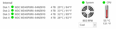

hello, just a fresh user of the ReadyNAS system  🙂
I just acquired (used) a ReadyNAS 104 and stuck in four 4tb WD purple drives I had salvaged and tested good.
Its taking days to sync, not unexpected but I am surprised by the CPU temp while its doing so...
55c seems a bit high to me...  Thought I should ask...  I did clean it out some but not extensively and its just on an open bench in my shop with ambient temp around 15c
Second question, when I go to copy all my data from my existing old Seagate NAS is there a more efficient way to do so than using an external computer as a go between via NFS or SMB?
I was going to take one of my spare Khadas Vim3 I have and load in Ubuntu so I could leave it for a few days to do the job...
Then I got to thinking, maybe there is an app I could load onto the NAS and do the copy more directly, NAS to NAS...  but of course the app store is not functional...
I have about 5.5tb to transfer...
ideas?

    justsumdad wrote:
    any input on the two issues?
    Sorry, I thought I'd posted that.
    My RN102 has the same processor, and runs at 50C when idle.  So your CPU temp is typical.
    The NAS has a back up job capability that can copy directly from the Synology.  Protocol include rsync (which is what I use), smb, and NFS.
    You can set up backup jobs on the ReadyNAS to copy the data directly from the Seagate.  There are several protocol options - SMB, Rsync, NFS.
    Personally I use Rsync for NAS backup, but all of these are ok.
    How many days?
    You might want to download the log zip file and look for errors.  System.log, Kernel.log, Systemd-journal.log are good places to look for them.

      justsumdad
      Its been running now 42 hrs and lists just under 50% done.
      I did not think this is absurd prepping raid 5 on four 4tb 5400RPM drives...
      do you?
      Logs don't show any errors or warnings...
        It's been a while since I've seen this posted for the RN104.  But I think it should have completely finished by now.  This is assuming you aren't loading data onto the NAS during the sync.
        So I would look for errors in the log zip (which has a lot more information than the web ui)..

        justsumdad
        I will explore that backup more fully, it did not appear to do what I was hoping for but I may have missed something.
        I have prepped the Vim3 SBC with Ubuntu and have it as a fall back, it will be another 30 ish hours before I can start the copy job anyhow...
        I know I can start it now, I just don't like the idea of doing that while the sync/format is going on.
        Thanx for the info on temp, makes me more comfortable  🙂
