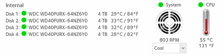

ReadyNAS RN104 fresh setup to replace Seagate NAS
hello, just a fresh user of the ReadyNAS system 🙂 I just acquired (used) a ReadyNAS 104 and stuck in four 4tb WD purple drives I had salvaged and tested good. Its taking days to sync,...

My RN102 has the same processor, and runs at 50C when idle. So your CPU temp is typical.

So my main concerns are the CPU temp and secondary concern is a method to copy my file base over without use of an intermediate computer...

Thanx for the info on temp, makes me more comfortable 🙂
