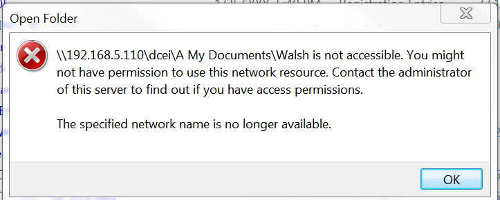

It seems that the issues aren't limited to just the one directory I found this morning. The samba share is generally unstable.
Example of the error shown in Windows
Example: Earlier I could go to the A-Electrical folder and look at things, now it flashes “This folder is empty”, then it reverts back, and it keeps flashes back and forth between the two.
