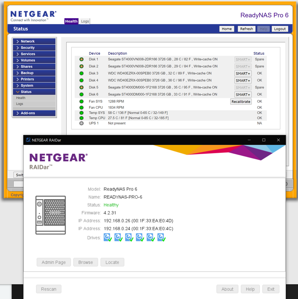

I have the Readynas READYNAS PRO 6
All of the six drive bays have 4TB ST4000 Seagates Iron wolfs or WD 4TB and all about eight years old and has never missed a beat
I lost access to the NAS in Windows and saw that Drive two was going to fail so I replaced Drive two.
I replaced it with a similar drive type but new and formatted, never used.  I have four Rapid replacements HDD waiting in my office
Firmware:     RAIDiator 4.2.31
RAID is X-RAID2
Drive two started to recover and at 6% it became a Spare at the same time Drive ONE start to give warning about to fail, so I replaced it as well and it now is a spare also, it did not try to rebuild.  I now have dive six saying it needs to be replaced before it fails.  Also Drive five satred in the last minute.
Why does the replaced drive/s not auto rebuild?
Yesterday when I replaced the first drive in drive-bay two it kept rebooting.
The log file is a zip file I cannot open. All zip programs present an error when trying to un-zip. I've redownloaded the file several time with the same result.
The folder structure is there but cannot access files,
Still accepts credentials.  When I try to access a +folder, it gives me an error "Check spelling of Drive. READYNAS-PRO-6 cannot be found".  I also get this error.
Can anyone help or know why my drives a systematically failing and not rebuilding whn replaced.
Can I force the drives to rebuild?
I can get to the NAS but the Folders are inaccessible.  It now is stable as of the first picture where the drive are in spare setting and not rebuilding.

    Though it isn't clear on what exactly happened, it sounds like you tried to replace multiple drives at once (replacing a second drive before the first had resynced, and then repeating that mistake with two more drives).  RAID can't handle that, so you likely lost your volume.  It can't rebuild at this point.
    You can confirm by looking that the volume page in the web ui.
    If you don't have a backup of the data, you will need data recovery of some kind.  Netgear does offer a service for that:  https://kb.netgear.com/69/ReadyNAS-Data-Recovery-Diagnostics-Scope-of-Service
    Another thing you could try is to power down the NAS, and install the original drives in their original slots.  Then power up the NAS, and see if the volume can be mounted.  The challenge here is that the more things you try, the more difficult data recovery becomes.
       I was thinking this maybe an option and will try.  I'll let you know how it goes.
      Just to be clear, I swapped the first disk and it went to a spare after say for a day or so that recovery was 6% and was not moving.  On the third day the NAS advised me that drive 3 was failing and needed to be replaced, so I did, it immediately went to spare no recovery was started.  At some point within a few hours, drive 6 started showing up as a spare?  Drive 6 log on the web-interface showed it wanted to be replaced as it was failing as well.
      I work in a data centre, in my entire life I have never seen a three-drive failure, never ever. The two disk failures are rare but have had some over a year and very common is one disk failure on any raid.  I believe there is more at play here.  Having said that, for the last 5 days it all stable with the layout in the photos, but cannot access the data and drives sitting on spare.
      I'll let you know how replacing the drives go.  Thank you for your assistance

        Volume re-sync is a drive intensive process and could drive more than one drive over the cliff to failure.  But you may be right and there is actually somehting wrong in the NAS itself that's causing the drives to appear unhealthy.
