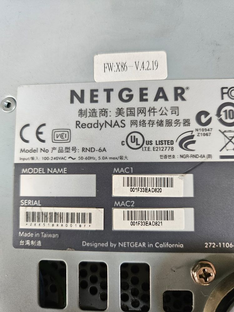

i have just been given an old 6 bay NAS , sticker on the bottom shows as per below.

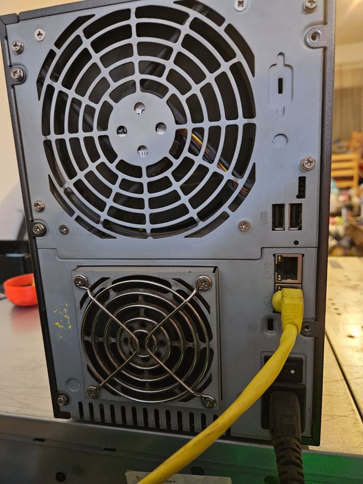

Ethernet ports are not showing as being active and i dont see an ip address being assigned on my router.

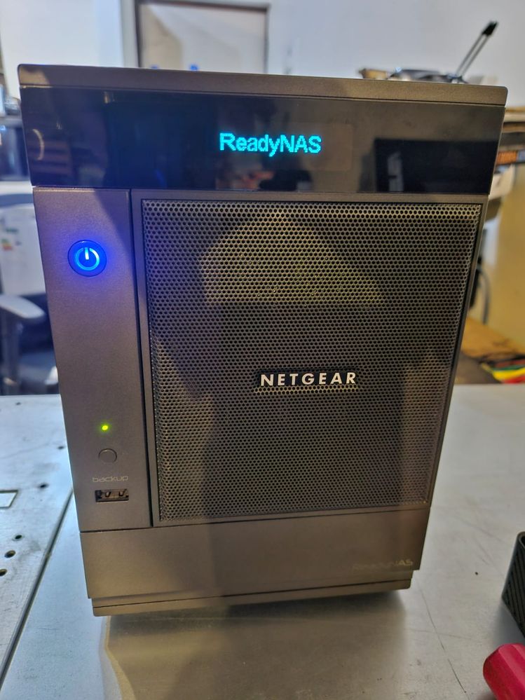

Front panel shows
i tried following readyNAS reset instructions , power off , hold reset , power on . it just seems to do nothing . i presume i will need to re load OS or give it a proper reset ,possibly removing cmos battery ? maybe .
any assistance would be greatly appreciated.

  • An RND-6A is better known as an Ultra-6.  Apparently, there are many like yours where Netgear failed to print the model name in that blank box.  The power supply for that model is a standard SFX form factor.  Some of those have an offset fan, so it's best to avoid those.  Most do not have the required 3 4-pin MOLEX connectors, so you'll need a SATA to MOLEX adapter (or two) or to transfer the 90° connectors from the old to the new.  The main 24-pin cable is too short on every one I've tried except those already modified for the ReadyNAS and require a 6-inch or so extension.  Although the original is a 250W supply, it delivers more +12V than most of that size, so you should go with a 350W or more.
    Sounds like a failed PSU (even with the "ReadyNAS" on the LCD panel).
