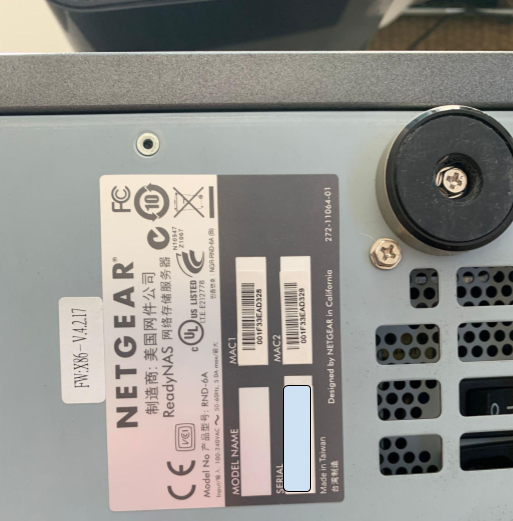

    • Connor158910's avatar
      Connor158910
      Guide
      I'm not 100% sure on how to check the model number. The only model listed on the bottom of the device was the "RND-6A" as it seems the model name sticker is missing.
      Photo attatched below.
      Are there any other ways to check? It looks most similar to https://www.netgear.com/support/product/rndp6000-200_readynas_pro_6/
      Although the bottom right on the front only says "ReadyNAS" not "ReadyNAS Pro"
      Thanks!
  • I believe you have an Ultra-6 (RNDU6000).  A Pro model should say ReadyNAS Pro on the front.  Can you get to the reset button menu? (How-do-I-access-the-boot-menu-on-my-ReadyNAS-Ultra-6-Ultra-6-Plus-Pro-6-Pro-Pioneer-or-Pro-Business-Edition).
