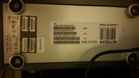

- I have a ReadyNas -> Netgear RNDU2120-100PES (check image below).
- It has a "blue light" - but the network port NIC seems totally dead. Not link at all. So my guess unit works w...
